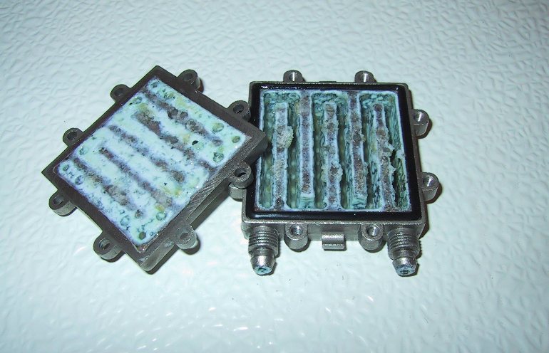

After taking out the waterblocks and opening them up, you can see
another reason why there was soo little water flowing: GUNK!
There is GUNK growing inside the waterblocks. The gunk can be
removed with an old toothbrush or something, but you still have
to clean it out about once a month or so. I don't want to do that,
so I'm replacing the water cooling with regular fans...
