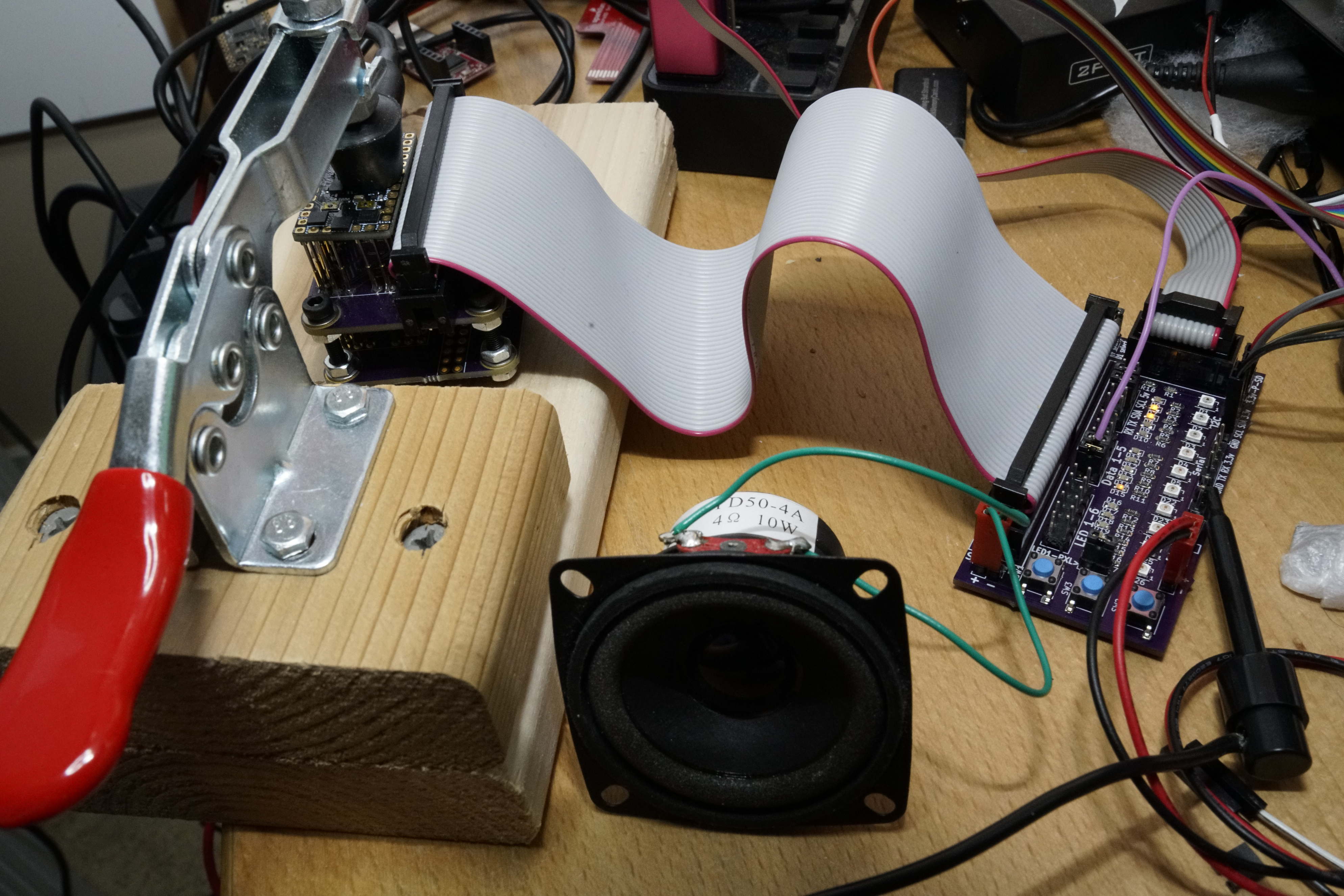

This is a breakout board that makes it easy to test a Proffieboard without having to solder a bunch of wires to it. With the right adapter, this test setup can be used to test and prototype with both V1 and V2 boards. Note that this test and prototype rig has several parts, each with it's own we page.

Just hook up the right adapter to the breakout board. Hook up power to one of the two power inputs. (Make sure to check the polarity!)

  1. Insert SD, put board on test rig, lower lever
